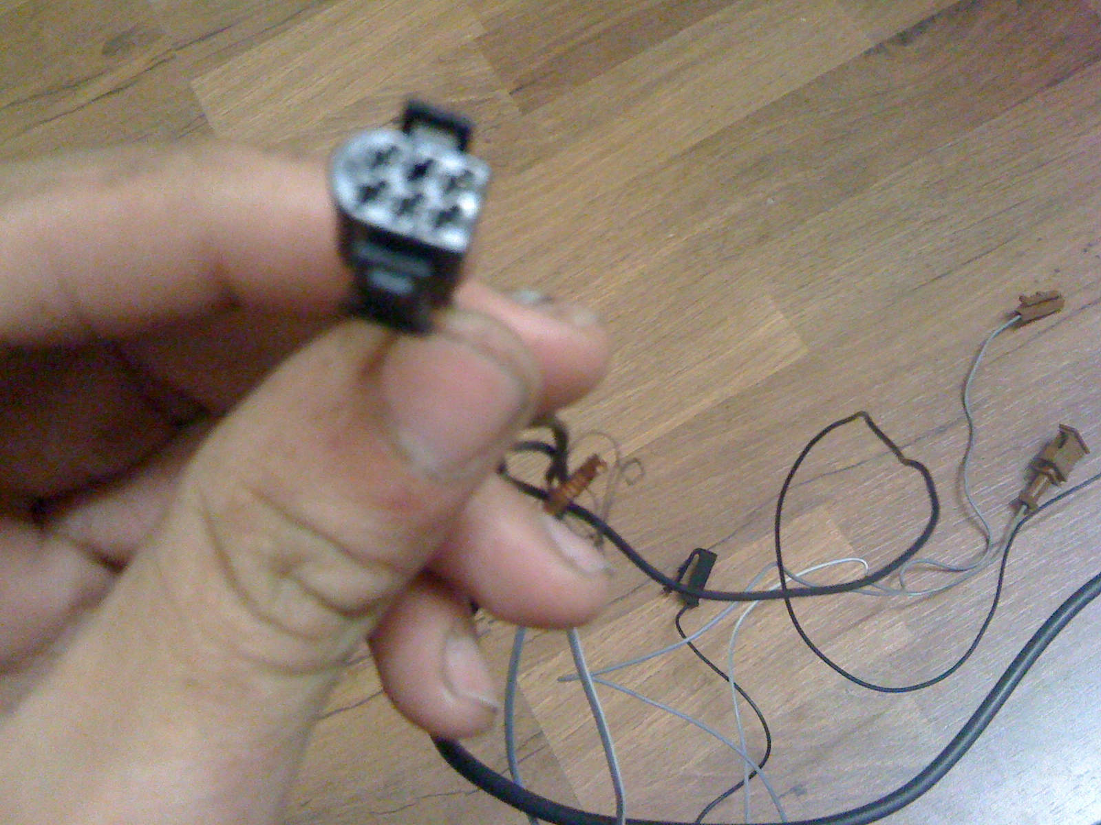

hi... where does the brown wire which comes off the transponder box loom go to? its the small skinny plug and is in your first picture.
many thanks
Re: Transponder problems? have a look here
Posted: Sat Aug 20, 2011 1:24 am
by cespo500
The two browns go to earth, Black wire goes to e2, Now for the gray wires with the male end that goes to your body harness, (The plug will look the same), and the female side will go to your obd port.
