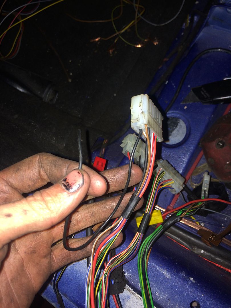

Hi all new on here although I have been using the site a lot but this is my first post,
The picture below is of the harness I have for my conversion, on one of the threads on how to wire your mk2 vr6 on here it shows a relay, a green plug for a mini fuse and a black plug (wipers) which also gets fused but I don't seem to have them here?
also on plug G1 terminal 3 is a black wire (think it should be red/yellow) and has been snipped, could anyone tell me where this should go.
all input is greatly appreciated, cheers

The Relay in the how to wire thread is on later harnesses. If you dont have it that you are ok without it.
Yeap looks like G1/03 that is the fuel pump relay. Look at the harness for the other end of it.

I had a look through the harness and can't find where it's been chopped from, where should it go?
also this came from a 1997 car on a P plate isn't that the later version?
