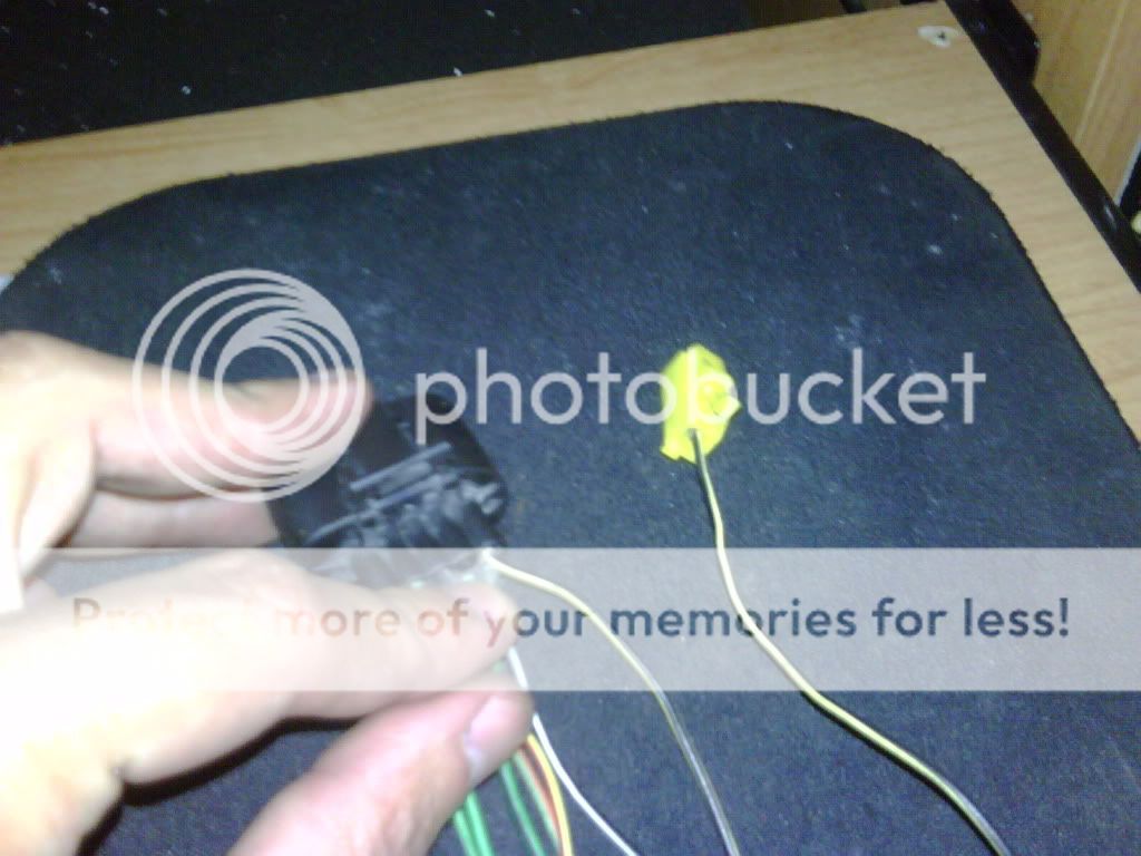

Ok, so my aux. pump isn't running, I tried jumping the yellow connector and I still got nothing, checked all my fuses and they are all good. I hooked up the aux. pump straight to the battery and it works perfectly.....what do I do next, just run my own wires directly to A1 #7 and ground?
btw everything worked fine and the car ran cool before my fusebox got wet (don't ask) but I put a new one in along all new relays and now it overheats :cry:

Postby cespo500 » Wed Sep 01, 2010 3:02 am
on the fan control module the small plug there will be number on the back of it the aux pump is pin 9 follow it and you should see a small yellow plug

Postby B5in » Wed Sep 01, 2010 2:43 pm
I can't find that wire & I wish there was a fan control module but the PO just hooked up the fan, horn, lights and who knows what else to these 3 relays you see here:

Postby cespo500 » Wed Sep 01, 2010 3:38 pm
ohhhh man its pin number 31 in the big circle plug on the side of the head red/black wire
