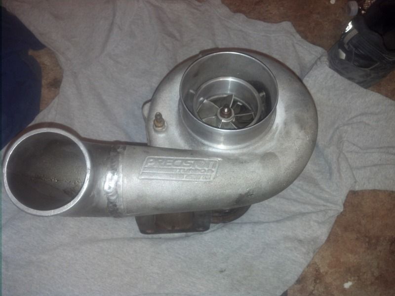

precision 6766 .68ar exhaust
beast turbo for a vr6.
this should go great with my promaf and stage 3+ ECU +injectors.

Killing them with the power to weight ratio right now... Really thinking about selling the precision turbo... it might be way to big to suit my needs.

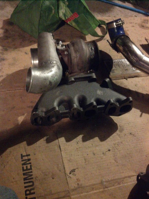

So, i put in the fuel pump, works great.
Could not boost past 15 psi and i was getting a knock in cylinder 5
Inspected my coil pack and it was cracked so i did the ford conversion.
Still the car wanted to spit and sputter under higher boost levels so i began to make my SRI intake so i can start running my bigger turbo.

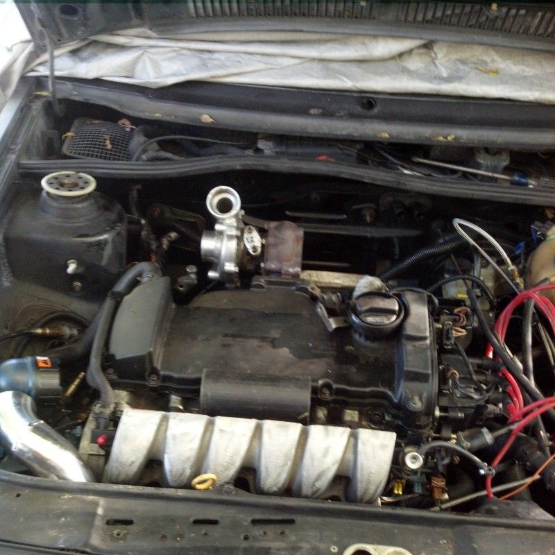

During this process i took the intake off and found out my current turbo had horrible in and out shaft play. left and right not so bad.... weird. like the bolts came loose.
On with some photos.
With the small blown turbo on the manifold...

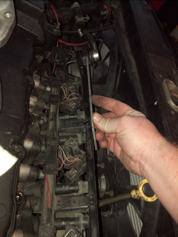

Seems i have bent my fuel rain sometime in between pulling the motor a couple times... need to re-shape or re-place in order for my SRI to work
The 4" vband on the turbo exhaust is going to be cut off and replaced by a 3"
The 2-3/4 cold pressure side 90 is going to be cut off and rotated for better placement.
The pipe for the SRI is on the way as well as the Vband flange kit for the turbo.

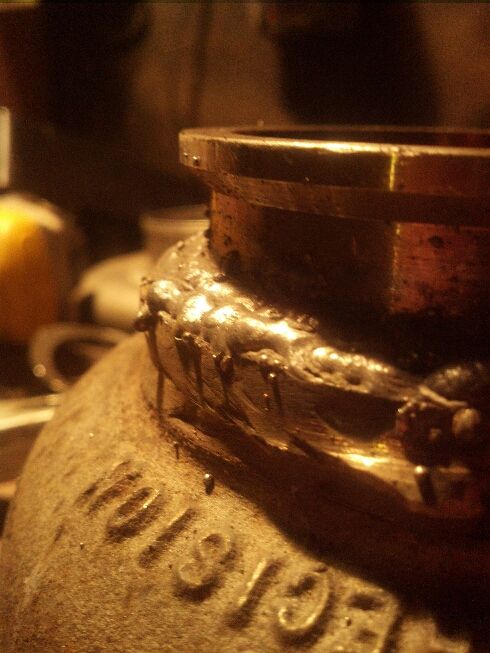

3" vband welded into the turbo..

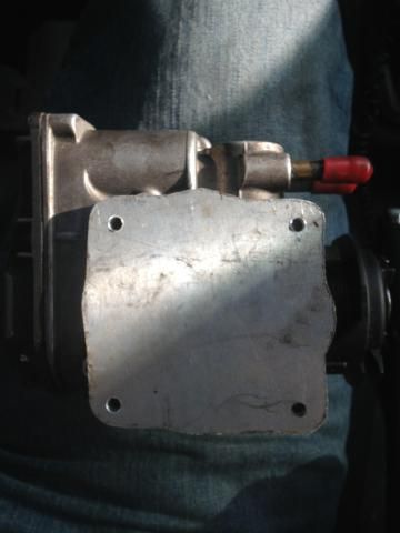

Throttle body plate cut out and drilled. Need to tap the holes. Since this pic I used a hole saw and cut out the center..

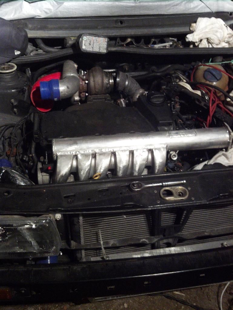

Postby deezy » Mon Dec 02, 2013 9:47 pm
Intake was sent off to a welder...
Exhaust system is 90% complete. Full 3"
