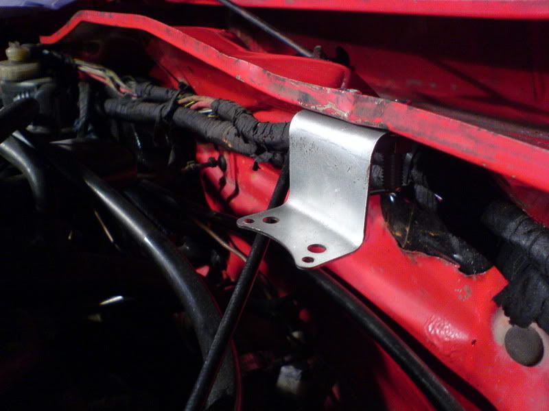

3. choose location of valve it self. I chose to attach the valve to the bulk head, I used two sturdier bolts then those supplied to attach it to the bulk head I also had to bend the braket supplied so the bonnet would close i thought the outcome was quite good.
4 Attach the Valve to the braket using bolts and nuts supplied. using the red tube supplied run this to the vacume on the side of intake manifold. i run mine under the coil pack to keep it out the way.
